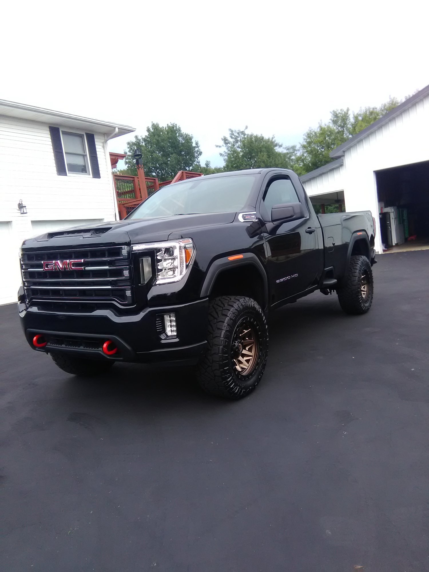

This may or may not help, but look at the leveled or HD pic thread on this forum and sift through to get some good ideas (it really helped in my parts selection). Really your truck should look very similar with given lift just longer. Also you are diesel so you have more nose weight but that's OK cause my particular lift has a lot of room for front adjustment ( lots of thread left on torsion bolts) and I'm reg cab long bed 3500hd. Just for reference mine is cognito performance 3in level with fox 2.0s ,diff drop ,pisk kit,1in rear block kit and Nitto ridge grappler 35/12.5 -20. On fuel covert bronze wheels 20/10 -18 bs. And if you wanted more rake you could always go with 1.5 / 2.0in rear blocks to get the look you want.
