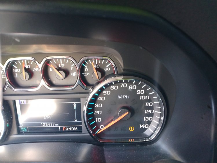

Well I replaced the thermostat, and drove it down the road and back, and it went up to 210 and stayed there.  Also my oil pressure dropped back to about 40 cruising, and down to 20-30 at a hot idle. Haven't seen the Check Engine light back on yet, so I am hopeful!IMG_20220509_162732872.thumb.jpg.477c2ef1bf325c042abf162207e15591.jpg
