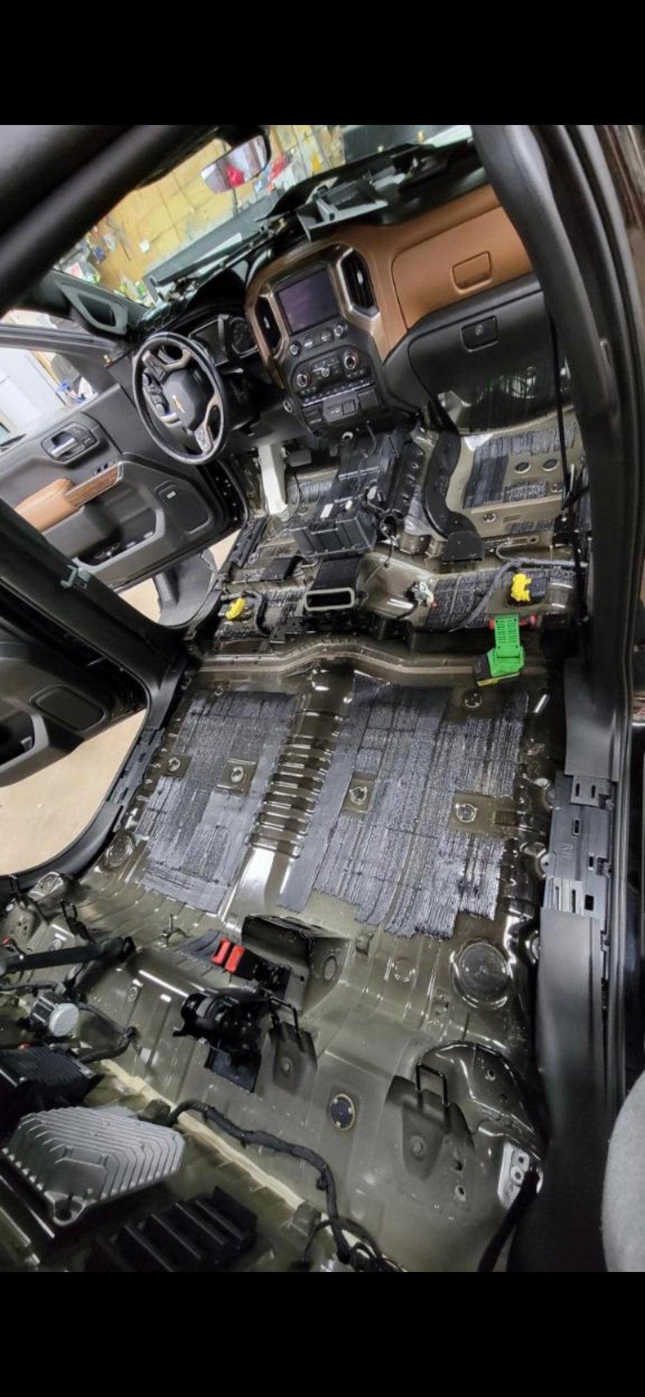

Well unfortunately I can’t upload the pics of the DynaMat Xtreme I added to my interior.  But that’s what I did and it took the edge off.  I covered the entire interior along with each door.

I don’t do it myself…I had it done by a local company.  I have a 2020 Silverado High Country so it’s pretty quiet from the factory.  So that’s why I say it took the edge off.  It’s not a drastic change but it does make a little bit of a difference.  I guess it would have been better if I did a before and after with a decibel meter. Hope this helps.

They are on Long Island in NY so it’s a small mom and pop Interior car and truck shop that I’m sure won’t know anyone from Michigan. The DynaMat Xtreme material cost about $400 for the floor and back wall and fire wall which you will need about one box of large sheets plus another 5 sheets from another box and the door panels (from Crutchfield) that were specific to my truck were about $300. Labor was $400.  So $1,100 for the whole job. Took about 5 or so hours.
