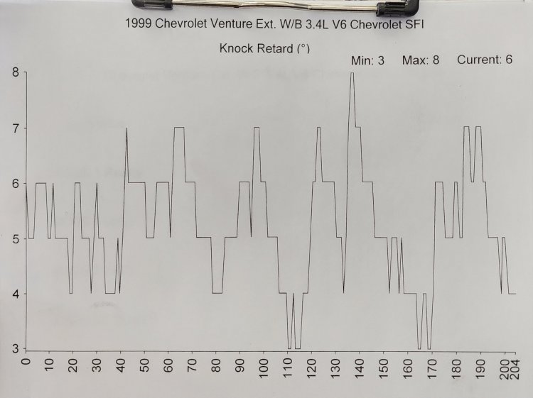

In other news, the knock re tard (I cant believe they block this word... I mean I understand but its not always derogatory)  is all over the place from 3 to 8 degrees.

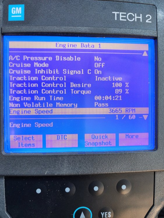

That's strange, along with traction control being commanded at 100% when it's not even moving. Unless I'm reading that parameter wrong, that's an issue. Not sure that would cause a high idle, but that shouldn't be happening.
Unless the TCM got a blast of coolant, that took the TCM out. The line that came off sits above the transmission underneath the exhaust. Also it could make since, if traction control is being commanded at 100% it could be the source of the 37% engine load causing the idle to increase. It is only at 1600 rpm in gear, 3600 in part or neutral. If I pull a plug on the intake it starts bouncing off the redline. I Unplugged the maf, iat, tps, egr all at the sometime while running to see if I can get a difference... none.
