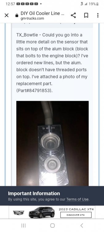

Changing engine oil cooler lines on a friend's 2019 silverado lt, purchased gm genuine lines however there's a block off plug in both ports on the cooler "block" I feel like there should be threads underneath the block off plug but don't wanna ruin the assembly. Has to be done today. Anyone ran into this? Ordered the lines for the correct model just not sure I wanna risk it. The factory lines has what I would assume is the oil pressure sensor on the first port. Pic is not mine but same situation...
That part # is for 2014-2019 trucks, NOT the new 2019+up trucks.
You need part # 86788215.  They are on backorder from GM, but as they get them in they are shipping.   They come with the sensor already installed in the line.
