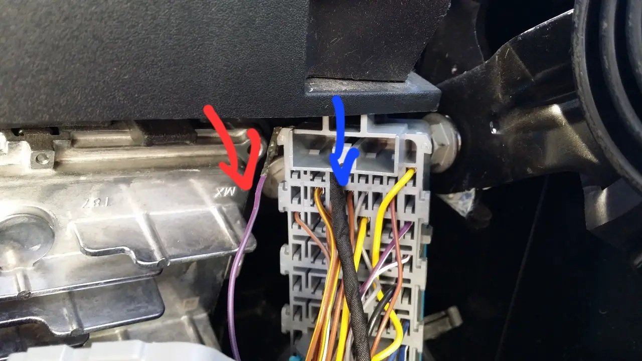

You'll have to remove the wire for the 3rd brake light from the back of the plug on the under hood fuse block and install the one from sport bar. You'll probably need this for the headlight switch. Here's a picture of the wire you need to remove (red arrow) and the wire you add (blue arrow)

Would you know which one of these wires are for the "Bed Light"
Once again Thank You!
The purple one is truck 3rd brake light. The Black taped one is sport bar 3rd brake light. The wires for the offroad lights ties in to the 3 prong plug I don't have that light kit so I had to run my own wires. Here's the offroad light kit instructions
