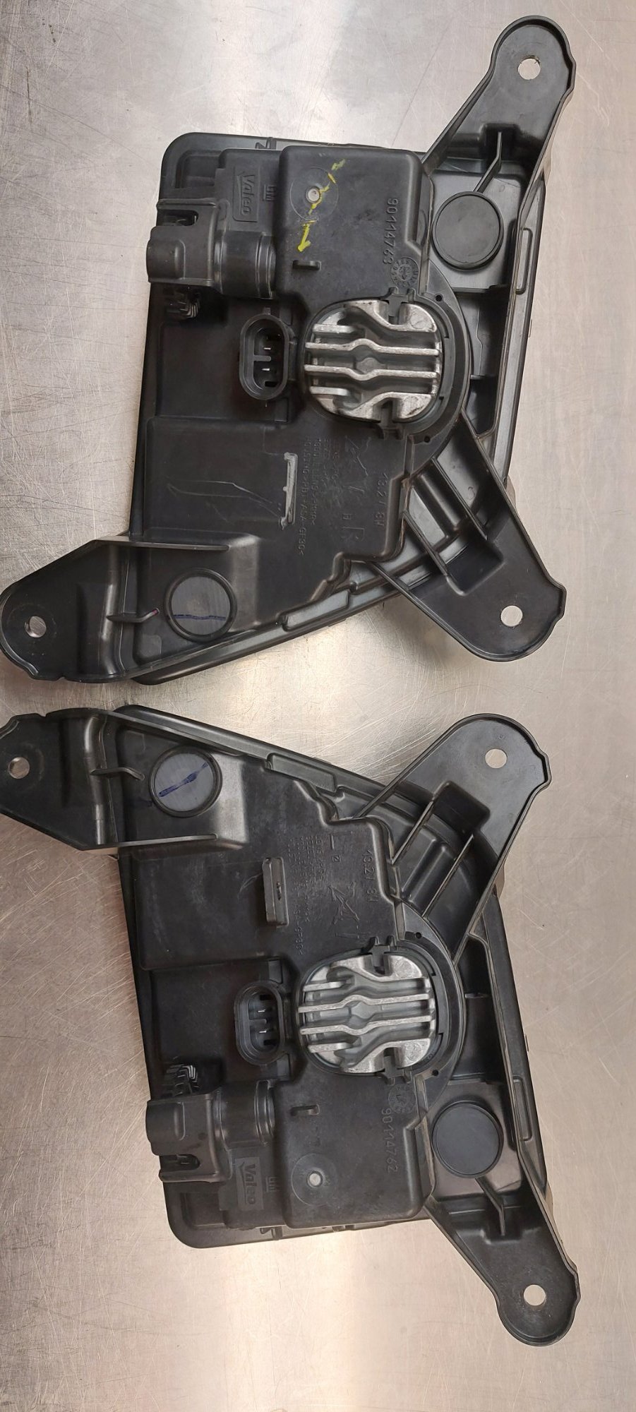

I have my 2022 OEM factory fog lights available for sale. These were removed at about 500 miles and in like new condition.
One of them has a tab on the back missing (top one on backside photo). I removed them when the truck was new so I don't exactly remember, but I think it was to help secure the wires.
$150 firm
paypal only
