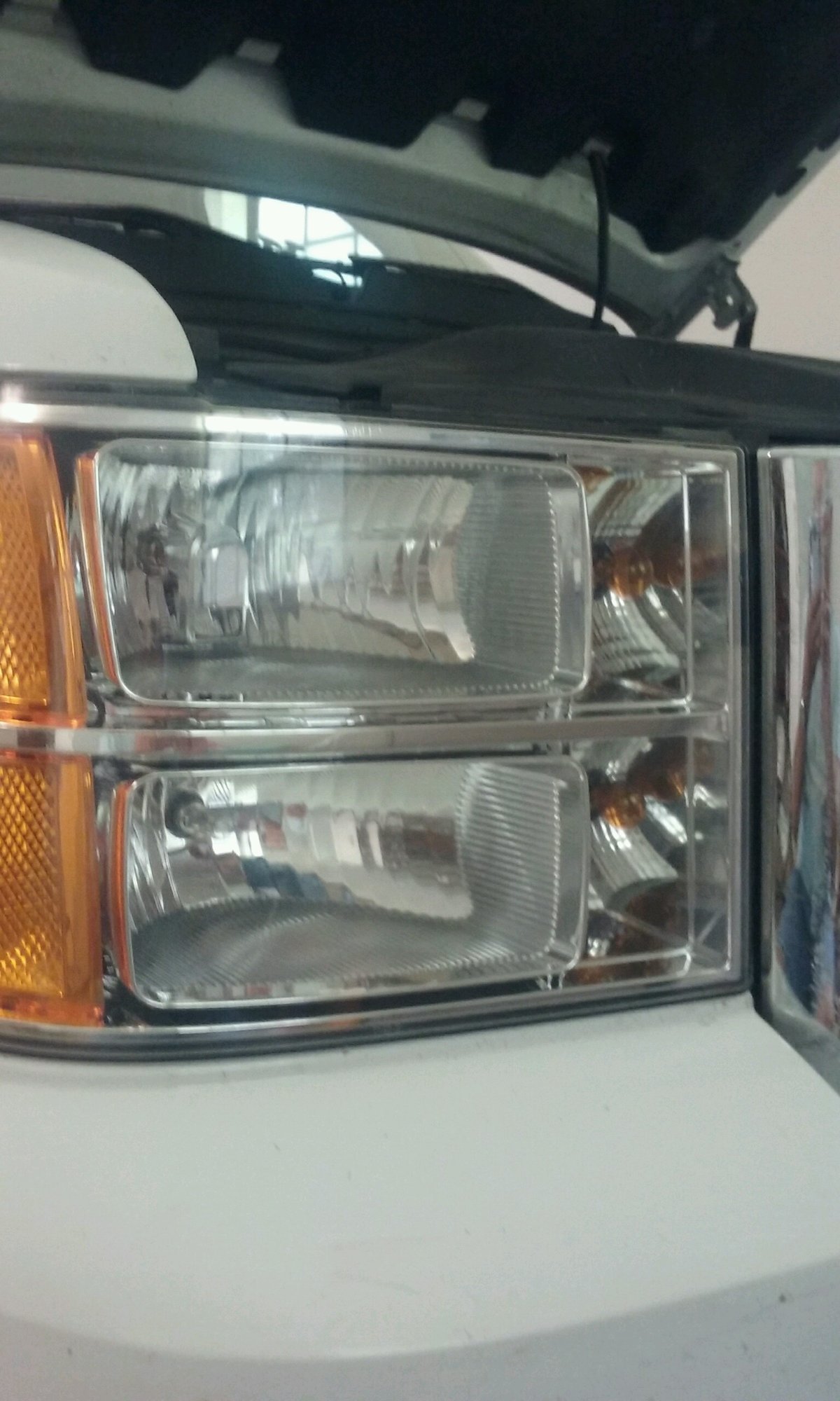

Jworks Posted June 30, 2023 Author Posted June 30, 2023 18 hours ago, MaverickZ71 said: What works best on the relatively soft 'crystal' clear plastic headlight covers on the GMT-900s (2007-13 1500s)? Our 09's have really gotten scratched up and yellowed suddenly (automatic car washes?) over the last 3 years or so. MaverickZ71, see the other replies on this thread. Although, I think BB68's idea of using a body shop clear coat is probably the best long term I will likely be going with the 3M Ultra Headlight Restoration kit. Only reason I'll get the Ultra instead of the 3M #39008 is for the UV clear coat in that kit. 1. It'll likely last as long as I'll be keeping this truck, which is uncertain. 2. My truck is garaged 90% of the time; not sitting in the sun all day. I haven't yet bought anything as of yet; I've just been getting info input from people. I'll be buying in the next few days. 1
Jworks Posted July 4, 2023 Author Posted July 4, 2023 Well after much deliberation I went with the 3M Ultra (with the clear wipes as the final step. Worked out good IMO. Its garaged parked so I'm hoping it will last. It has a 2 yr claim. Even if I get a year out of it its only about an hour job for both headlights. We'll see. Thanks for all the suggestions. They helped. 1
