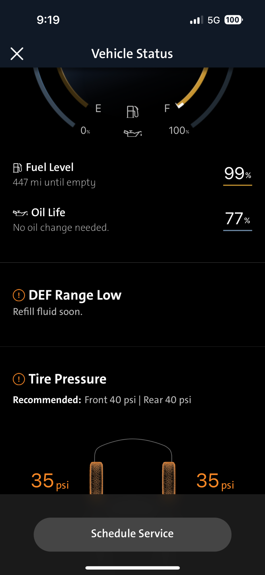

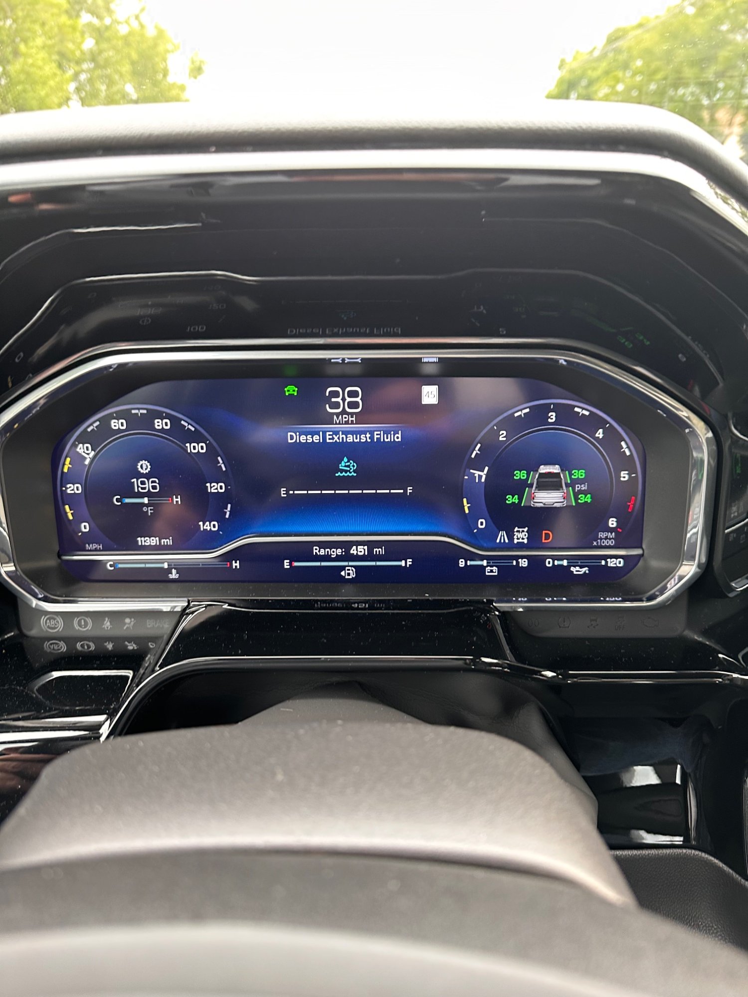

Any one have this issue with def range low popping up in cluster with mileage range calc but your def indicator lights show that it’s full?
Also says on App too that it’s range is low?
pic below.

On my '23, myGMC seems to always report the DEF level information as 'unavailable'.

What level does the info page in the truck say?
The current def level is about 2/3 full.  But there is an alert on the GMC app "DEF Range Low".  There is no alert on the Drivers Information Center (DIC) about DEF however, I read that the DIC only displays low range alerts at 1000 & 300 miles to empty.  So, I am interpreting with 2/3 full DEF tank, I am within 1000 and 300 miles on DEF range.
I'd be ignoring the phone app and going by what the truck is indicating.
Mine phone app always indicates def info unavailable -- but I've notice the other info is not always fully up to date.

I'm having this same exact issue with my 2023 AT4 (3.0L).  I have around 500miles on the truck and my DEF indicator in the truck is only down one line from full.  However, my MyGMC app has been showing DEF Range Low since a week after I got the vehicle.  Everything else in the app seems to be working fine...sometimes my PSI might be off by 1 or 2, but no biggie. GM tells me the DEF Range Low issue is an OnStar issue since only my app is giving me false info.  OnStar has elevated my complaint like 5 times now and gone through diagnostics over the phone with me like 10x.  I don't know if its an app issue or if there is something within the truck that isn't feeding correct info to the app, specifically the DEF Range.
I want to clarify that I don't get any warnings or popups in my vehicle cluster or dashboard...the ONLY issue is the app reporting DEF Range Low.

The DEF report on the app has never worked on my 2023.
The app always says def info is 'unavailable' or something like that. (doesn't say def low)
