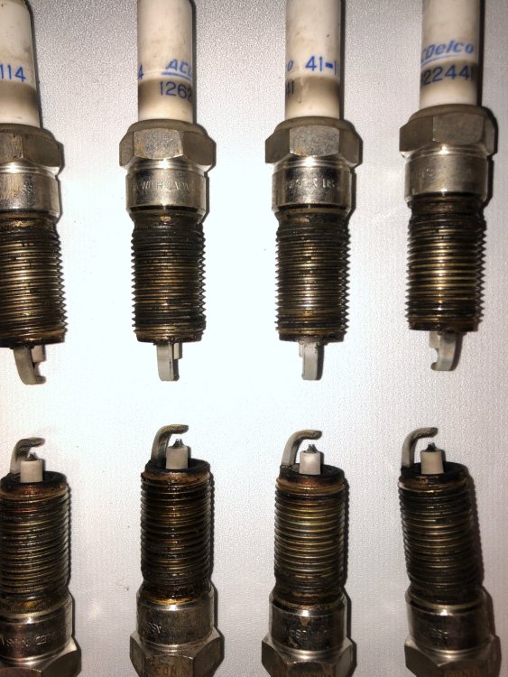

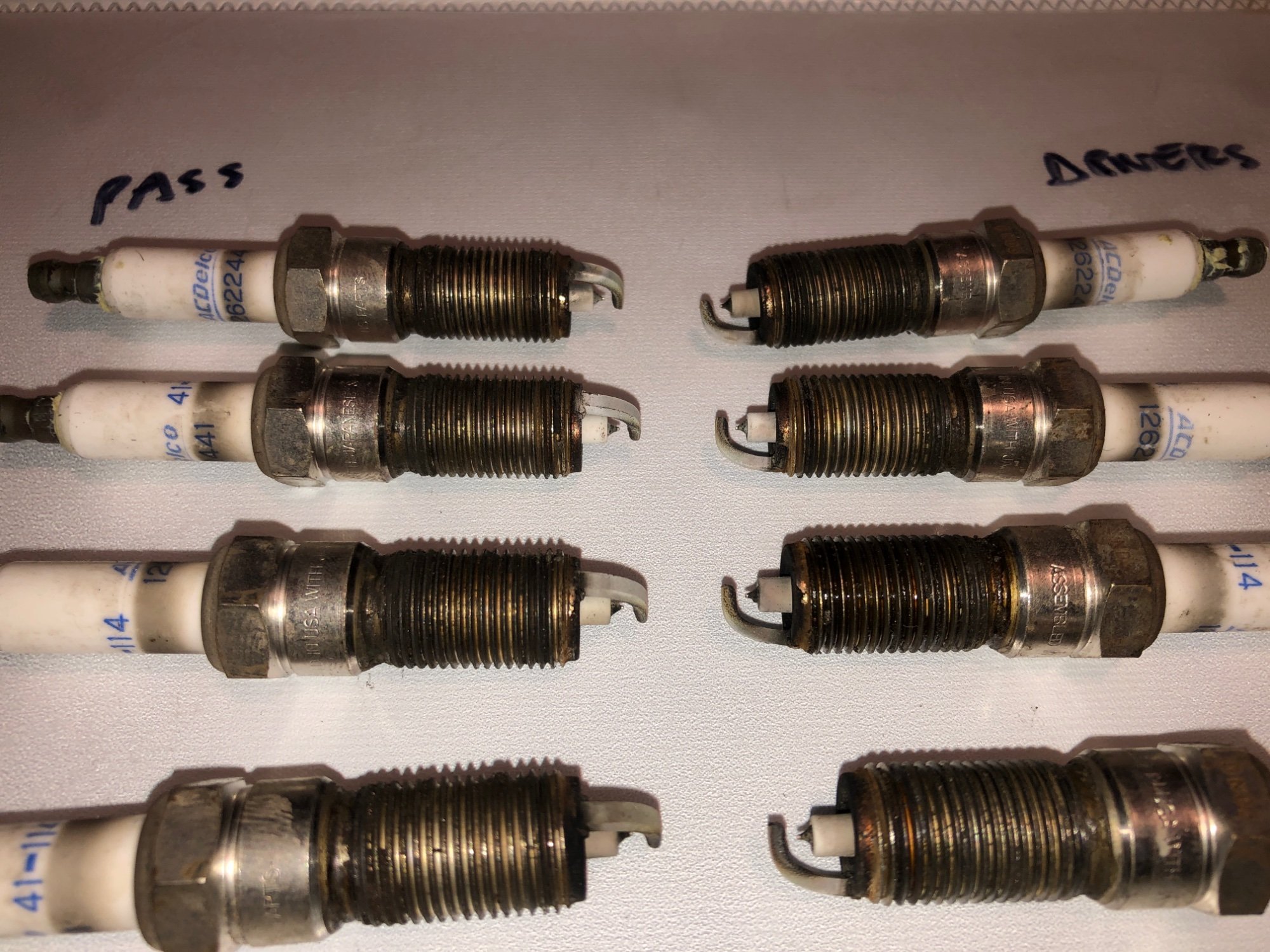

Very good.
They are not covered in oil, so swap and ride out.
Also may want to swap the wires and clean the inner connection of the coil as that is usually where the misfire can come from.
23 minutes ago, Snowcamo said:
Very good.
Wires are only 2.75yo now.  Man that rebuilt engine after a lifter failure put new ones on then.  Yeah;  100,000 in under 3 years!!!  Thanks.
