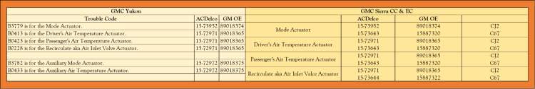

They must be recalibrated with a scan tool.  Unplugging the battery doesn't do it.  You also have to use the right ones as the wrong ones work the opposite or not at all.  Aftermarket actuators don't last if they even work.
Different actuators for different AC type, verify your RPO code versus the part numbers you used.
