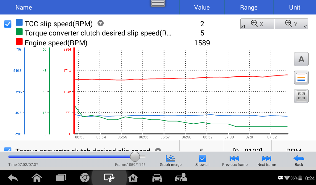

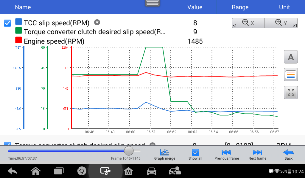

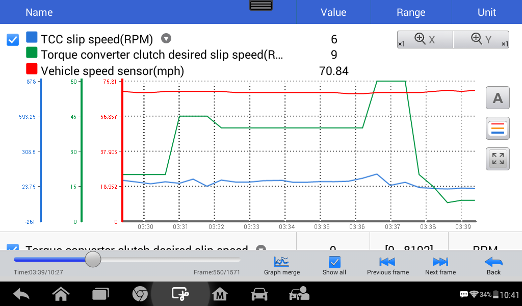

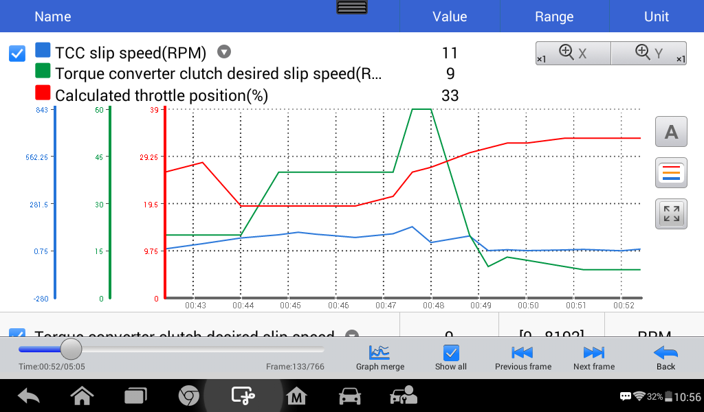

Attached some screenshots of the TC slip speed. Not sure if this is conclusive or not. The freeze frames were taken at the moment I experienced the issue. Note the live data numbers above the graph.
