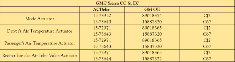

The driver's temperature actuator is in the passenger footwell, under that black cover near the transmission hump.  The passenger side actuator is basically above it, under the passenger side airbag.  So is the recirculate actuator.
Use the GM actuators.  I have tried to do a manual relearn after replacing mine but have always needed a Tech-2 or bi-directional scan tool to calibrate the new ones to work right.  Some folks are successful, never worked for me.
