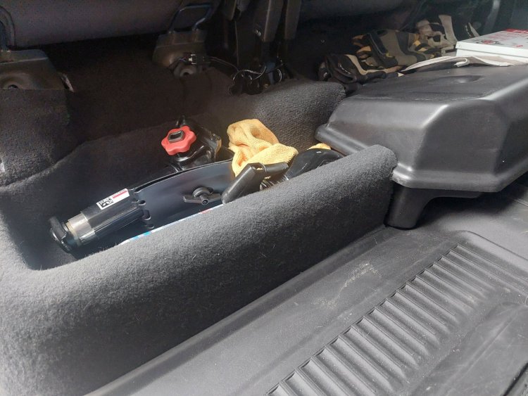

The sub storage is actually a bit taller than the stock compartment. I just installed mine yesterday and modified the factoray storage bin with a 4-1/2" grind & cutting wheel. Easy to do as they're just plastic with fuzzy stuff adhered to them. The jack bracket holds it in place securely with the 2 factory 10mm studs & nuts.
Edited by mtbadbob

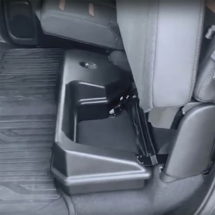

Hey, thanks for that. Looks like the sub is dead center. Do you have a pic of the other side, too?
1 minute ago, cheapie408 said:
The sub itself sits on the hump. Google is your friend
Thanks for that Pic. Looks like the enclosure is not ported at all. Is that yours or from a Google search?
