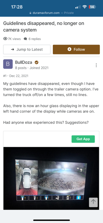

Hello all, I am wondering if anyone here can help with a fix for my issue. I have spent some time googling over the last year or so as this has been an issue on and off, it seems this issue happens across any type of GM Vehicle.

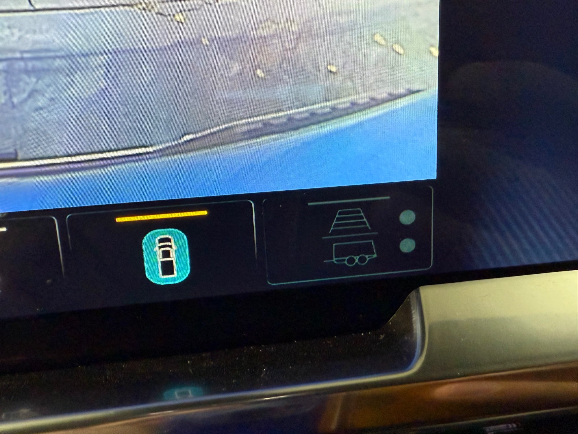

my lines have gone which tell me where I’m going when I park. The screen displays the camera just fine, but there is a blue egg time in the top left corner and the button on the bottom right that toggles the lines view on and off is greyed out.
this has been happening for more or less the whole time since I got this refreshed 2022 in 2022 however recently the lines went and never came back, usually it fixes itself.

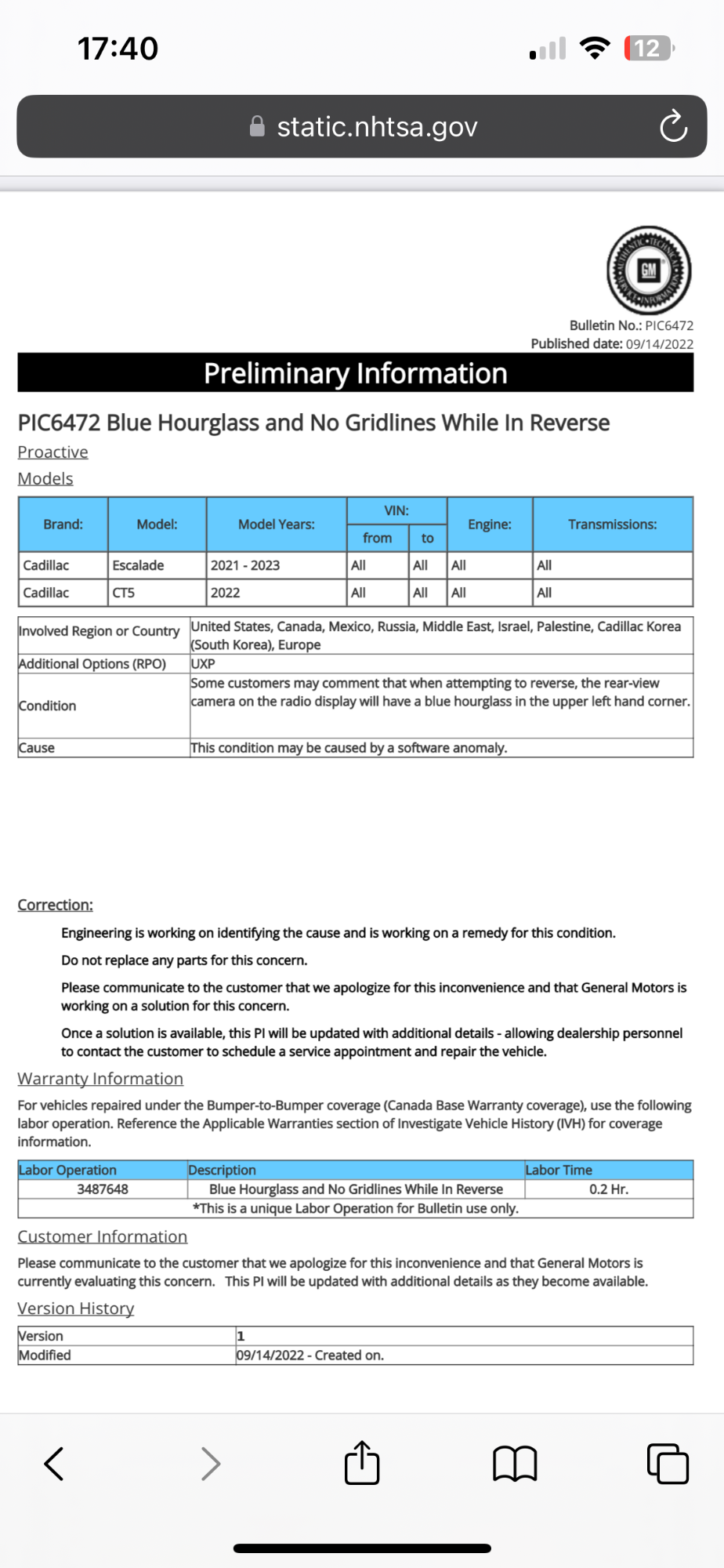

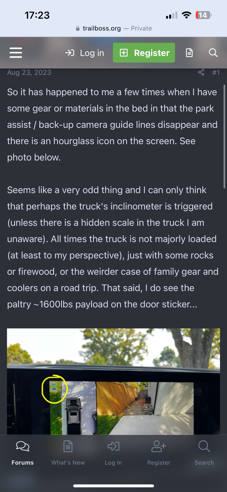

it even says on the attached Cadillac bulletin ‘may be caused by a software anomaly’
just needs a ctrl+alt+delete and a reboot!!

@2022LiftedRST Did you get any resolution to this? The dealer installed my leveling kit today and I noticed the same thing - no guidelines, disabled button for them, and the hourglass. Going to call tomorrow and see if they messed with any calibration, I can’t imagine that it can detect that it’s sitting a few inches higher. It’s a pickup, loading the bed or towing could just as easily affect its angle!

This button on the far right that’s now disabled? Or is there some other system setting I haven’t found yet? 🤔
