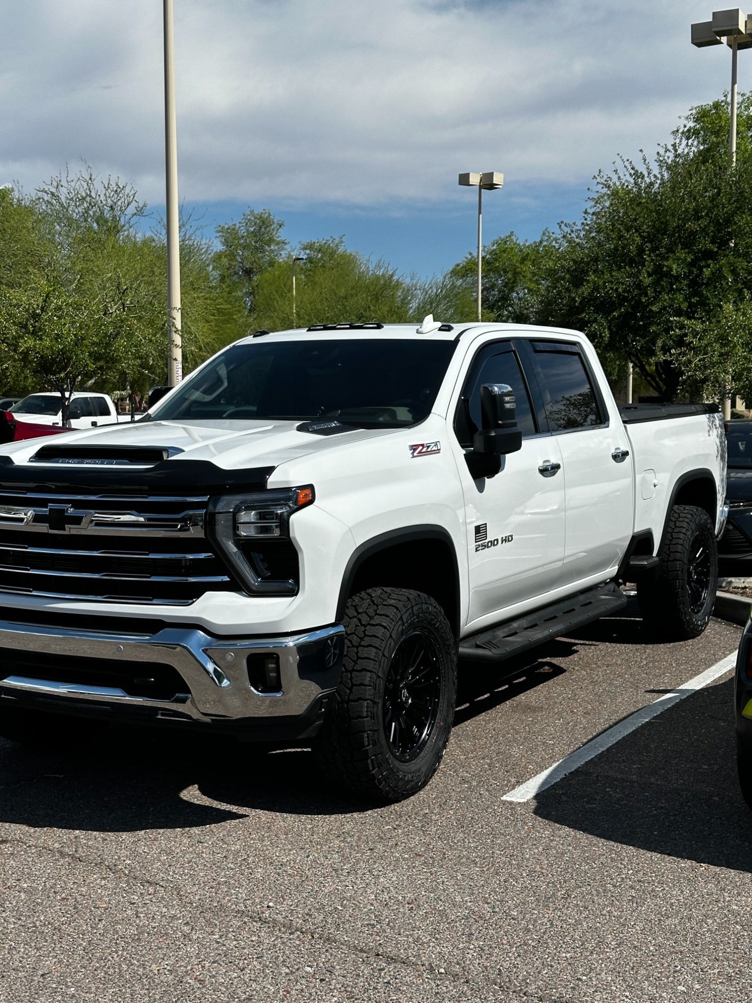

Just installed yesterday: Fuel Rebel 8 20x9 +01MM offsets on 35x12.5x20 Falken Wildpeak AT4W. There was a little rubbing of the front fender liner at full steer so I trimmed about 6" off the bottom of the liners and now have no other clearance issues. (EDIT: Sooo I found out that the trimming was actually unnecessary (DOH!). There's a bracket that is fairly thin attaching the front of the liner to the frame and it can be bent enough (~1.5" forward) to clear the larger tire. Although trimming it was unnecessary it doesn't look too bad so I'll take the lower case L on that one).

Just installed yesterday. Fuel Rebel 8 20x9 +01MM offsets on 35x12.5x20 Falken Wildpeak AT4W. There was a little rubbing of the front fender liner at full steer so I trimmed about 6" off the bottom of the liners and thankfully no other clearance issues.
looks really good man!......looks more proportionate
