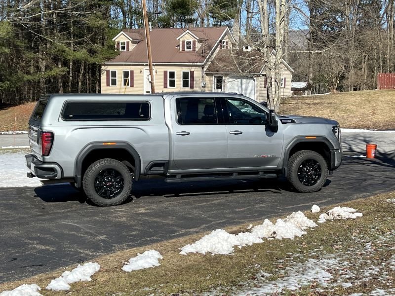

I don't think that my truck looks gangster with the OEM 20" wheels. I think there was an 18" option but then I couldn't get the BFG KO3's for summer tires. My GF's last two GMC Acadia Denali's came with 20" wheels and I think they look ok.
