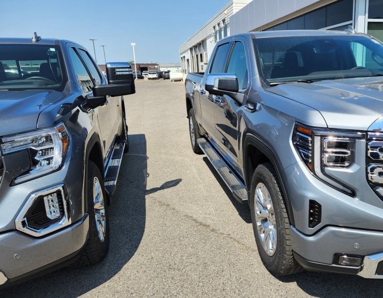

 I found a set of Mirrors, Ineed to check to make sure that they will fit my truck before I buy them. DS 84994407 and PS 84994408. The discription says that they will fit the Sierra and/or the Silverado, I don't know if that's true. I will also need to get a wire harness for them from what I can tell. I haven't found that yet.
  Thanks for the picture. I can do a good compairison with it.
 So what do you think of the small mirrors verses the tow mirrors? Are the tow mirrors noisey?

I can't help with the part numbers.
You could get a quote for 'price and availability' from a dealer parts department or from one of the online GM parts suppliers.   Parts department will have part numbers on the quote.
I have been a long time GM trailering mirror fan.
To make a long story short, I found (on a '21 1500) that the blind spot on passenger side when checking to the right at intersections was worse than with previous generations of cab/tow mirror.
I didn't notice them being noisy.
I factory ordered them on the  '21.
They were power fold.
As pictured, I ordered the  '23 without tow mirrors.
The '23, doing same tasks, is getting better mpg as the '21.
For my use, all the cameras have reduced the need and benefit of upright trailer mirrors.
Might be different if a lot of camper or car hauler width towing is done.
Packages with all the cameras will still have all the cameras if ordered with tow mirrors.
Before adding them, I'd suggest finding one with the tow mirrors to drive. (buddy, demo, rental, etc)
Drive an area, with lots of stops/intersections/corners to deal with.

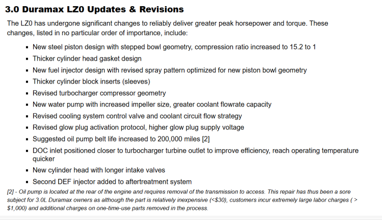

Interesting to know about the oil pump repair. I'll have to keep that on my raidar now. I wonder if adding a second DEF injector increases the amount of DEF used.
