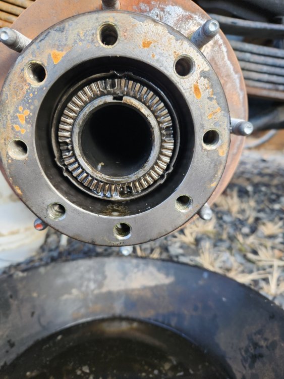

1 hour ago, mrjulian416 said:
You have to remove the hub nut to remove the rotor?  Is that a 3500 DRW thing?
2500 rotor removal
Dually thing.  On these 2020-up the hub is bolted to the rotor.  You have to remove the hub and rotor assembly to then access the bolts to separate the rotor from the hub.  The prior generations so 01-19 trucks the wheel studs where what held the rotor to the hub so you had to pull the hub and then drive the studs out to separate the hub and rotor, replace the rotor and then flip it over and drive the studs back in to put it all back together.
