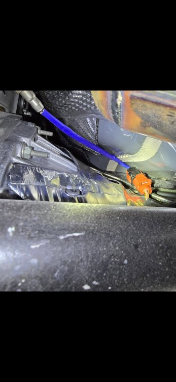

I bet you will most likely find the rattle coming from the o2 sensor plug under the driver side next to the transmission. Give it a look and see if it's hitting the tunnel like mine was.
