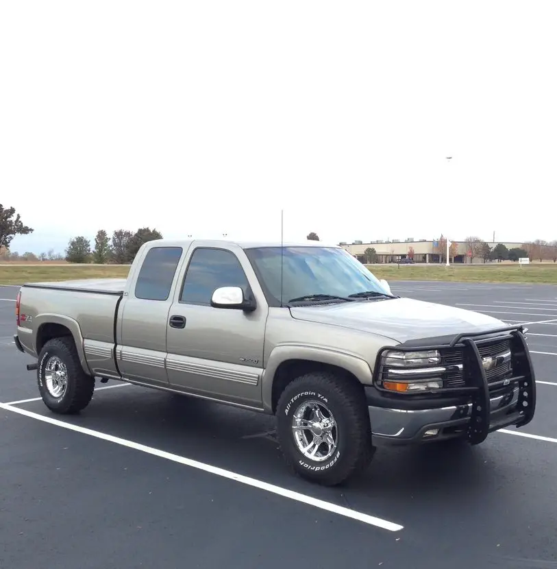

Hello, after having this truck for 24 years, someone tried stealing my pride and joy a 2001 Silverado 1500 z71.
they removed the plastic shroud around the ignition and put a screwdriver in the key cylinder cylinder.  So I had to carefully drill out the key cylinder and I replaced it. However, the key cylinder won’t turn all the way back to shut the car completely off. I believe this has to do with the Ignition lock system so someone cannot remove the key when the truck is still drive. I noticed the white clip on the ignition control lock cable was missing in the ignition
housing but I put it back in and it still doesn’t seem to work.
