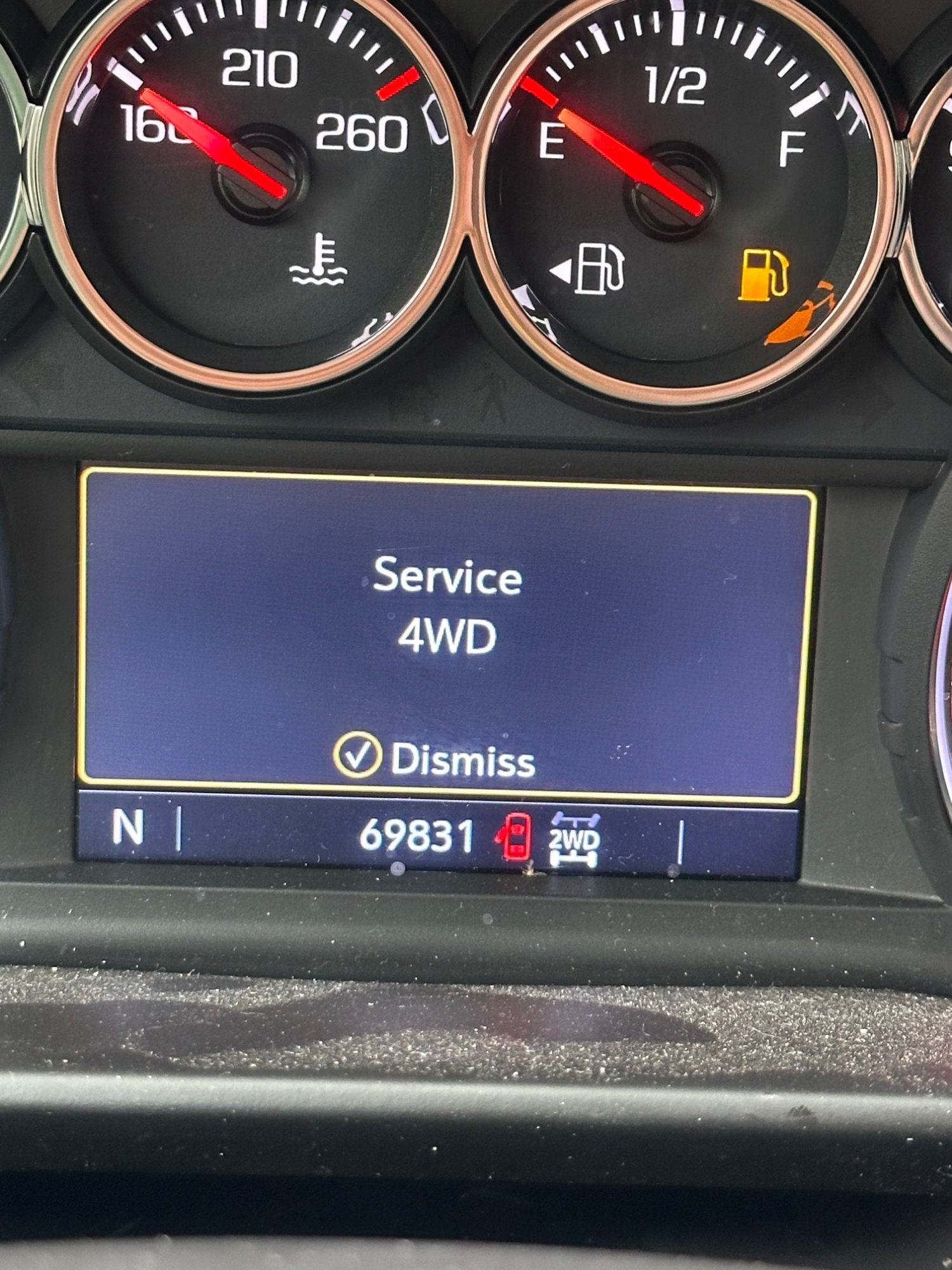

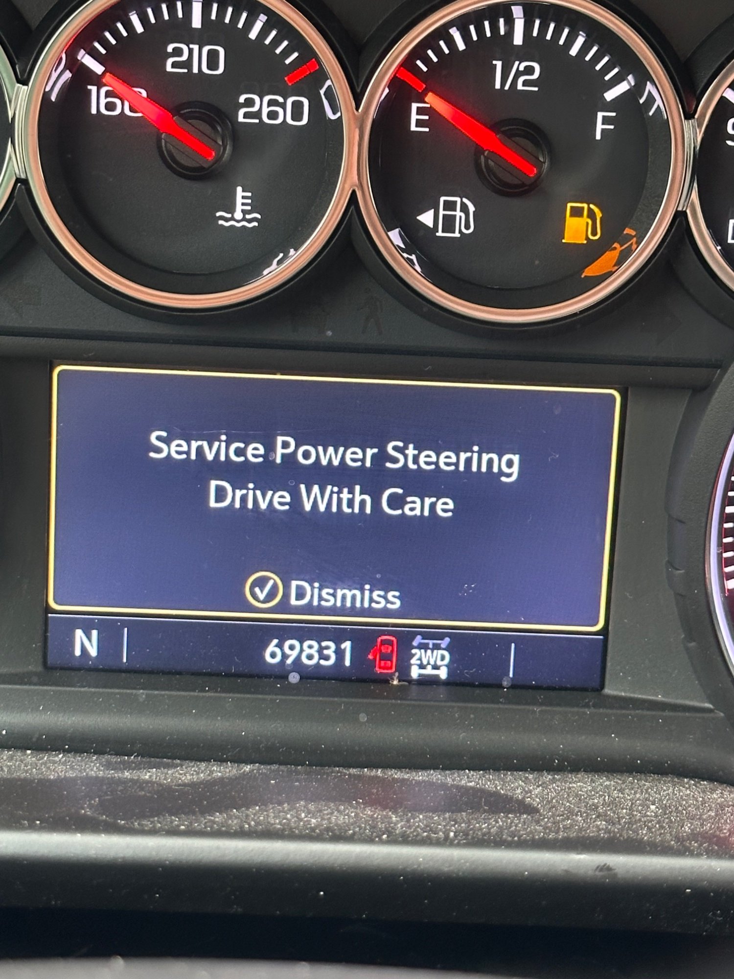

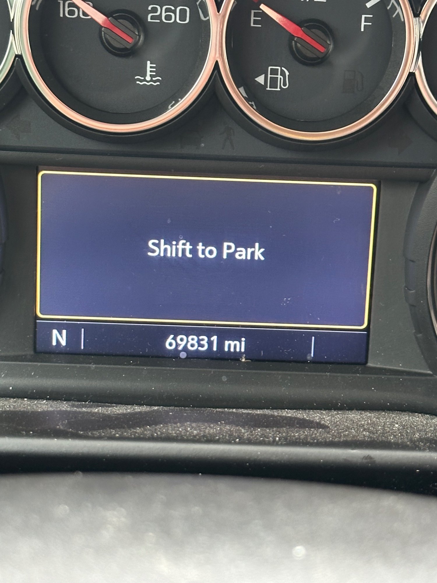

went away for a few days came back home, went to drive the car and I had 3 new lights on that will not allow the car to start.
- Shift to Park
- Service Power Steering Drive With Care
- Service 4WD
have no idea where that came from as I drove it the morning before I left on Tuesday morning and came back Thursday evening.

I did that but the message does not go away. So I can’t even start the car.

Stupid question, but did you make sure it is shifted into Park?  If so, have you tried shifting it to Neutral and then back into Park?
Of those 3 messages, Shift to Park is probably the only one that won't allow the engine to start. Like Trans said, try running the shifter through the range then back into Park. You could also try wiggling the shifter around a little in Park while trying to start it.
Unfortunately guys I have literally done everything already. 😭 I even disconnected the battery and connected positive and negative together to let it reset and that look promising at first, but the messages came back. I have also messed with the switch underneath the steering wheel column. That seems to be a problem and it is clicking someone did say that it could be the battery but even when I try to jump it from another car looks like the battery should be where it’s at to at least start.
