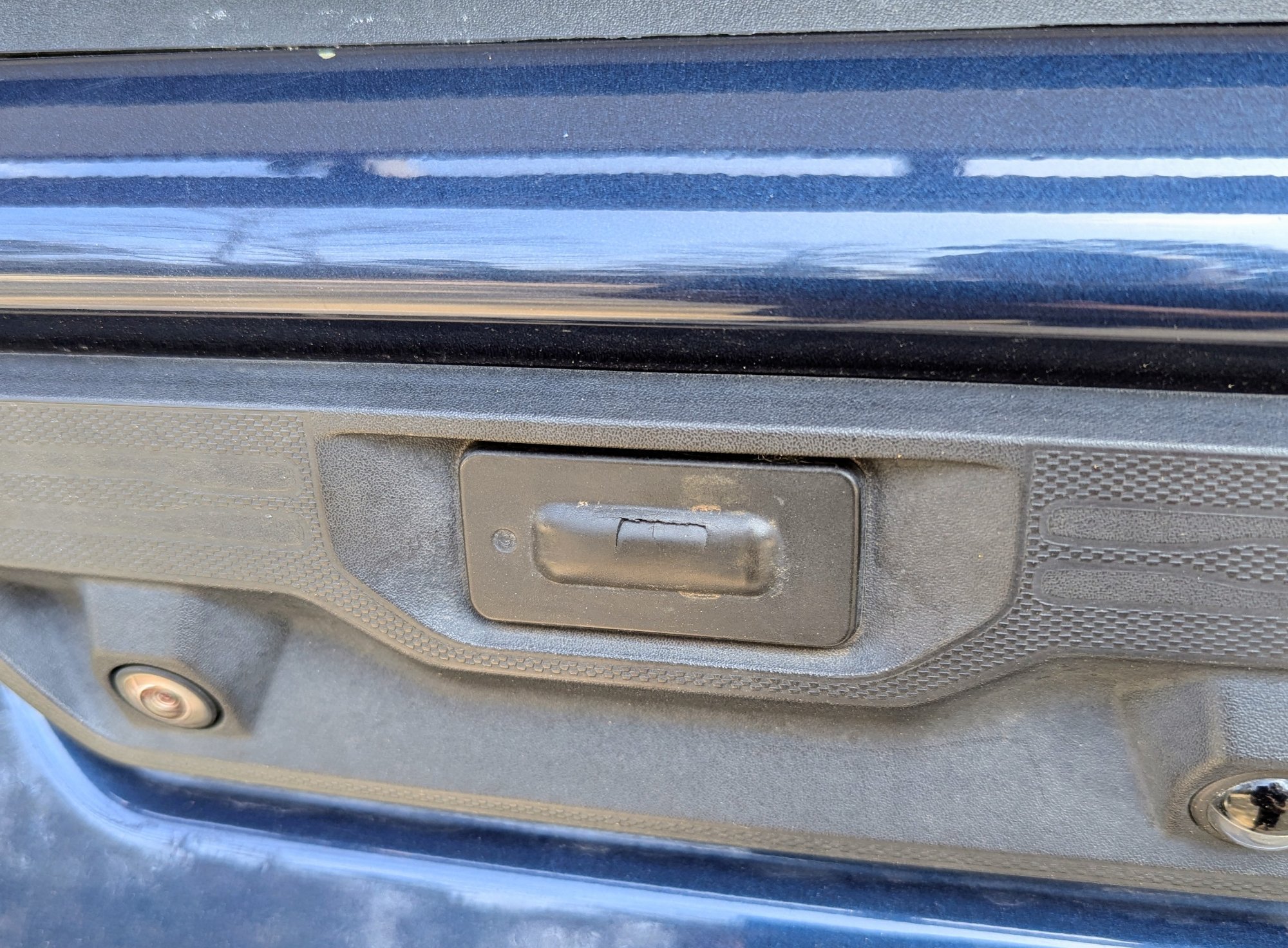

My 2021 2500 HD has a crack in the exterior tailgate touch pad that opens/closes the tailgate.  (see the pic) I use this switch often.  It's exposed to the weather, so I'd like to replace this insert plastic cover to keep out the rain.  (FYI, the truck has about 40k miles and is mostly garaged.  I'm surprised that this item would crack after about 5 years of service.)  Does anyone have the part # and a source for me to obtain a replacement?  Thx!
Looks like that pad is only included in the whole handle. The handle part number is 86569330 and is around $150.

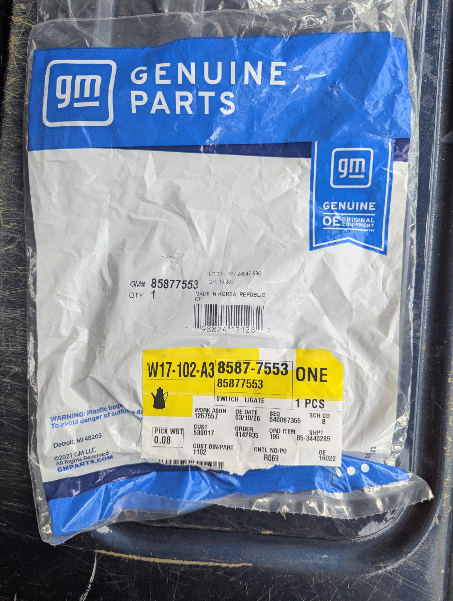

To close out on this (my) post about the tailgate touch pad, I just installed the replacement.  About 10 minutes, easy, fits well and easily accessible via the detachable panel on the inside of the tailgate.  I've attached a photo of the part from gmpartscenter.net.  $5 for the part + $15 shipping.  I wish all fixes were this easy!
Part Number Part Name Price Quantity Total
85877553 Tailgate Release Switch $5.02    1 $5.02
