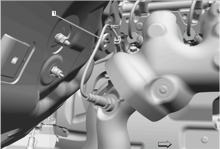

Hear a sloshing noise in the passenger side dash, water doesn't seem to be draining from the AC.  Can't find the drain! Seems like it may be clogged. Anyone know where the evaporator drains out in the front? Thanks!

Passenger center of the firewall behind the pass. side cylinder head/engine block.
Thanks!!! That was helpful had to get to it thru the wheel well, how do you clean it?  Any recommendations? Can't even fit my arm back there!
Seen guys do it carefully with a thin wire coat hanger.
