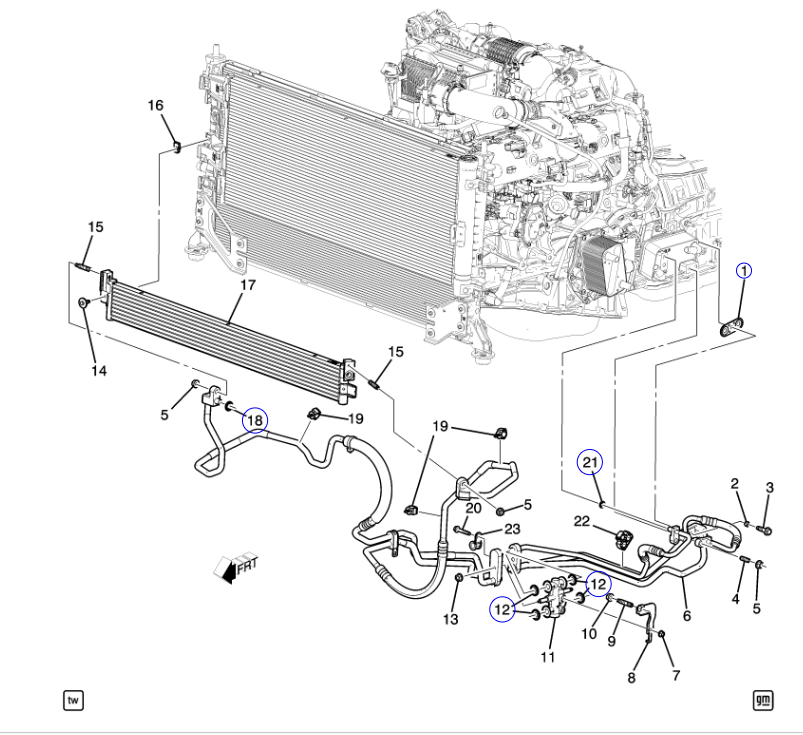

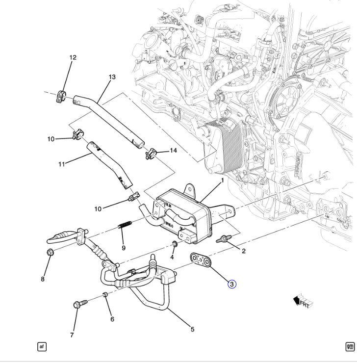

It is working as designed.  NHT and non NHT trucks have the same exact transmission cooling setup.  NHT just gets a larger radiator.
The transmission cooler loop on these is as follows.
-Transmission out goes into an oil to water heat exchanger (item #1 in the first illustration below).  This exchanger has engine coolant opposite the transmission fluid and uses engine coolant to warm and then regulate the transmission fluid temperature when its in the operating window.
- From the cooler it goes to a thermal bypass valve (item #11 in the 2nd illustration below).  If the ATF has not reached the temp to open the bypass (194F), it loops back.
- When it reaches 194F, the thermostat opens and ATF then flows out to the oil to air auxiliary cooler (item #17 in the 2nd illustration) at the front of the truck.  From there it goes back to the transmission.
Your only fix would be to swap for the PPE thermal bypass delete block which will open the loop to the aux cooler all the time.  It will STILL run warm, probably 170-200F, but that's as low as you'll get it as its still flowing through the oil to water exchanger.
    • It is working as designed.  NHT and non NHT trucks have the same exact transmission cooling setup.  NHT just gets a larger radiator.     The transmission cooler loop on these is as follows.     -Transmission out goes into an oil to water heat exchanger (item #1 in the first illustration below).  This exchanger has engine coolant opposite the transmission fluid and uses engine coolant to warm and then regulate the transmission fluid temperature when its in the operating window.   - From the cooler it goes to a thermal bypass valve (item #11 in the 2nd illustration below).  If the ATF has not reached the temp to open the bypass (194F), it loops back.   - When it reaches 194F, the thermostat opens and ATF then flows out to the oil to air auxiliary cooler (item #17 in the 2nd illustration) at the front of the truck.  From there it goes back to the transmission.     Your only fix would be to swap for the PPE thermal bypass delete block which will open the loop to the aux cooler all the time.  It will STILL run warm, probably 170-200F, but that's as low as you'll get it as its still flowing through the oil to water exchanger.
