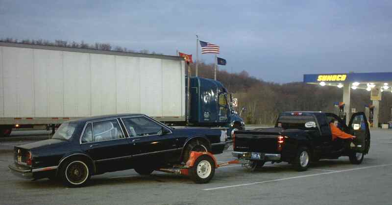

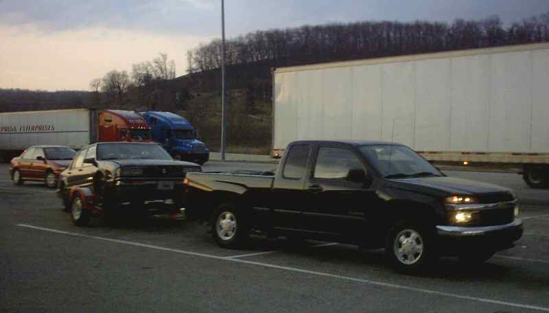

13 hours straight (except stopping for fuel refills and bathroom breaks...darn women can't go 3 hours without having to pee), and no problems. Plenty of power going through the mountains in PA, never hit halfway on the temp guage. I think my average speed on the freeway was about 75, got a whopping 15mpg, although I guess while towing at 75, thats not too shabby ;) Still had plenty of stopping power, I pulled off the freeway for a big and stopped in one of those "Emergeny stopping" areas off the PA turnpike and took a 15 minute nap 'cuz I was starting to fall asleep.
Dunno how much difference towing a boat on a trailer would be than towing a car packed full of stuff on a car dolley, but there's my experience for ya.
Thats a U-haul dolley, an '89 Olds Delta 88 with a computer and 17" monitor, 27" tv, 13" tv, and a bunch of other stuff crammed into it. The rest of my girlfriends stuff is packed into the bed of the truck.

Not sure if you saw my reply over on colorado fans or not, but here's another copy if it.
