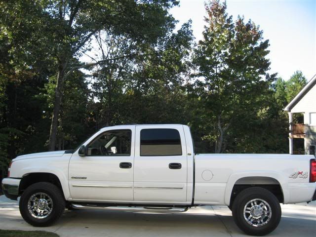

I need some help with a 1500HD. I just bought a new 2006 and took it to have new wheels and tires on it. I am running 285/70/r17 Toyo All Terrains. The local 4x4 Shop raised the torsion bars and I have plenty of clearance. Truck looks good and rides good until you go over a speed bump. The front end feels like it has no suspension. They raised the front quite a bit (close to 2 inches) so I suspected that the shocks were the problem. I had them jack up the front and the sure enough the shocks were bottoming out but their was less that ¼ inch from where the shock bottomed out and the bump stop. He said he can put on longer shocks but then I’ll hit the bump stop. Would hitting the bump stop be an easier hit than the shocks bottoming out?
If I lower the front I will get some rubbing from the tires. I think I might be able to lower it about ¼ inch.
Any other ideas?
I don’t want to drop lots of money on s suspension lift and have not seen a small body lift for a 2006 1500HD they all stop at 2005.

PS-Can you post a pic of your truck? I'd like to see how 17" 285/70-17 Toyo's look, that might be what I put on when mine are worn out.
Your truck looks really good with those wheels and tires, and that amount of t-bar crank.
So I did some refreshing of my knowledge of wheel offsets.
Your aftermarket wheels probably have 0 offset, and the factory wheels have a positive offset of around an inch or 25.5 mm.
So your wheels move the tire centerline about an inch outboard compared to my truck with the stock aluminum wheels.
This makes your clearance situation a bit worse than mine, due to that additional inch of outside dimension on your edge of the front tire as it tries to clear the front spoiler.
But still, I think you can take half of the crank back out of your front suspension and it will still look good, and you'll be able to get some of your ride back.
The ideal situation is to find a wheel that has a 1" positive offset. But I don't know if anybody makes one like that...
