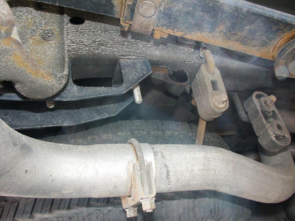

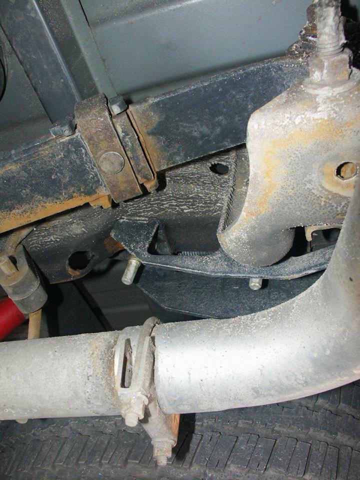

Back in December, my truck was hit on the rear and it sustained damage to the bumper and hitch. At least that's what I thought and so did 2 repair shops. Given the cost, I decided to do the repairs myself since I could get the parts cheaper than their estimates. This morning, I finally had some nice relatively warm weather to do the work.
I was upleasantly surprised to find that the hitch support brackets bent the frame! Have any of you out there had similar collision damage and have it repaired successfully? I have towed with this truck and still need it for the occasional towing duties and have some worries about whether the frame will retain its strength after being straightened out. Do I need to worry that my truck's towing career is over?
You have got to be kidding me. I got rear ended on December 18th while towing a trailer. The trailer was dinged up, but also the hitch bent my frame and even bent my receiver where the ball sits. Mine actaully was a hit and run, and they just now found the lady. My truck goes in the shop on March 12th and they expect it to be there for a week on the frame machine.

Kidding about what? How similar the pictures? tell me about it. I suppose as long as the process to straighten it out doesn't weaken the metal or if they reinforce it afterwards, I'll stop worrying. It's just that the left side rail is actually buckled on the sidewall and not just the bottom lip.

Actually, I didn't expect to see as much. I had been hit several other times by inattentive drivers and this one didn't feel that bad. I figure the ball mount on my hitch caused the most damage when the car hit it - pushing it down like a lever. I think I may leave it off from now on.
