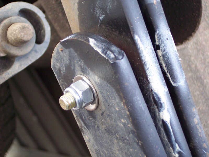

This is to the leaf spring slap and squeaking from the rear end. In an attempt to avoid the GM ones (since those too would likely fall out like the factory ones) I went to Energy Suspension for their low profile bump stops.
Popped those in my empty holes on the bottom leaf this afternoon and went cruising down the road and not a noise! Nothing!
It was absolutely fantastic. I thought part of my problem was the slip yoke, but apparently it wasn't. The rear of my truck is normal now!
If anybody else is wanting some, go to www.energysuspensionparts.com and search in the top right for 99132G. You'll need 4, so 2 orders does it.
They bolt in, so they should be in there for a looooong time. If anybody needs any input or help on an install just let me know.

Very easy to do though. Just jacked the rear up (front wheels chocked of course) under the diff. Removed rear tires. Placed a jack stand on each side of the frame as far back as possible while still being on a straight surface.
I then lowered the diff down to flex the springs out since the frame is sitting on the jack stands further up. This allowed the bumpstops w/bolts to go in easily with no prying apart leaves.
Just tightened them up and dropped the truck back down after putting the tires back on.
Here's some pics! The white stuff is lithium grease spray residue. Tried that first without much luck. The holes that the bolts go through are already there, so no drilling or anything needed. I added the washer separately as the nut was close to going through the hole. It was a 3/8" stainless washer. Nylon lock nut included with the bump stops.
