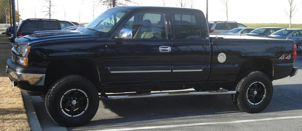

I have an 05 silverado 1500 4WD
I just got a new set of 35's and wheels - they came in mounted and supposedly properly balanced already
I just had a shop bolt em to the truck for me yesterday and now the truck vibrates when braking.
It usually doesn't start vibrating until the truck gets below say 30 and close to stopping.
Take my foot off the break vibration immediately stops.
Doubt if it's related, probably just a bad alignment...
I told them to check the alignment when they had it. Didn't want my new tires gettin screwed up, they said it was out.
They sware it's exactly where it should be but the truck is pulling to the right a bit.
Lift has been on there for about a year - breaking, steering etc have all been fine. No vibrations until the new wheels got put on
I'm guessing it's just balancing, but why would it only be when breaking????
But any ideas would be appricated.
Does look good though :)
Thanks guys, Kenny
