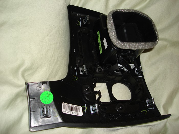

that's what i'm talking about. There are no screws that hold it in place. There are 6 clips that hold it in -five below the vent and one above. i'll post a pic in a minute.
here are pics. you can see the 6 metal clips that hold it in place. just pull gently and it will pop off. Maybe massage it out a little.
Great, thanks for the pic. Will definitely be taking mine off soon as soon as I figure out exactly where the rattle is coming from. Thanks!
