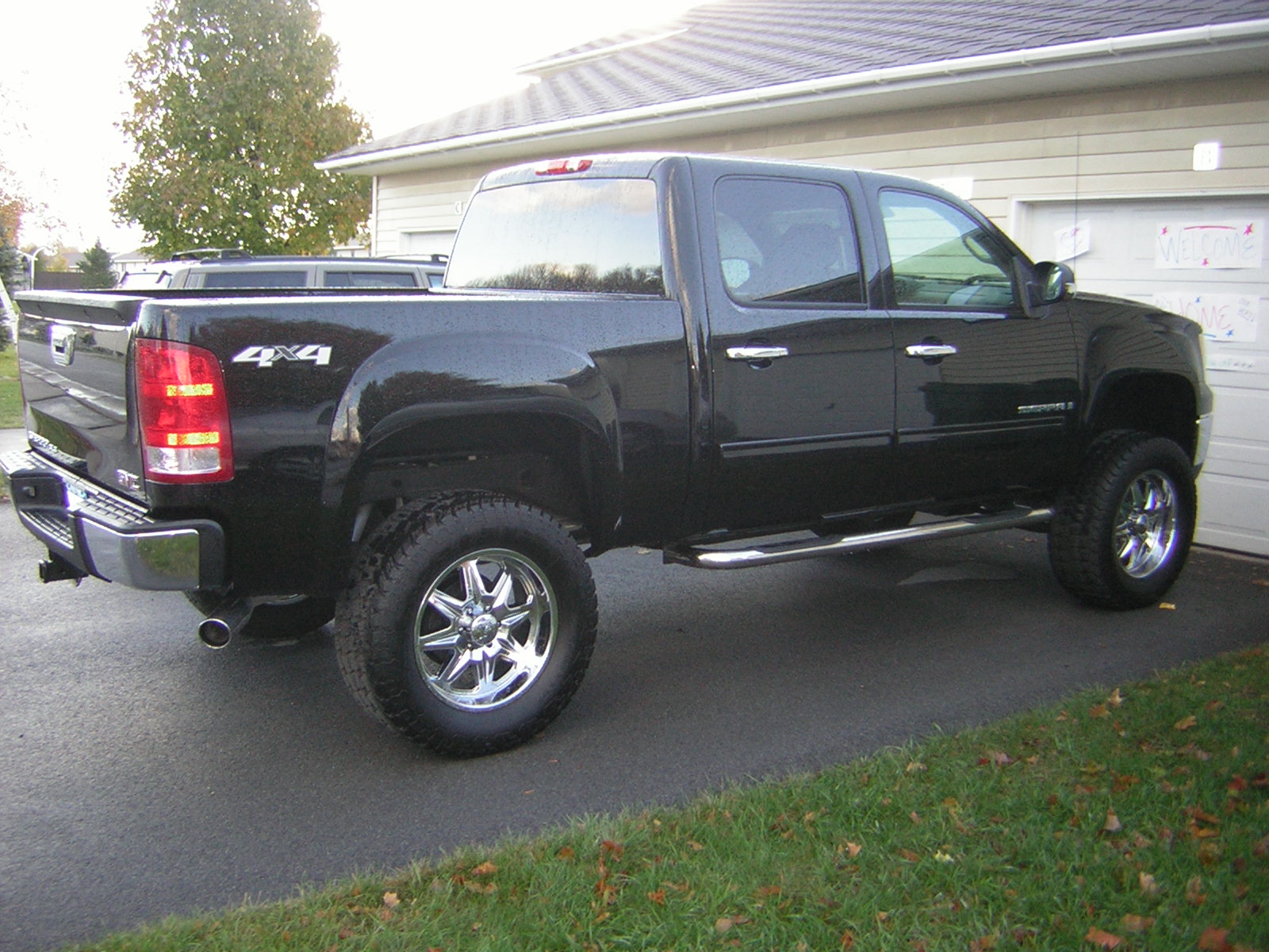

quick question i got the dr coilovers and now trying to get the rear lift but dont know whether to go with the add a leaf or 2' blocks with u bolts, does anybody know which is better, and the pros and cons with each? thanks alot.post-44155-1204317522_thumb.jpg
