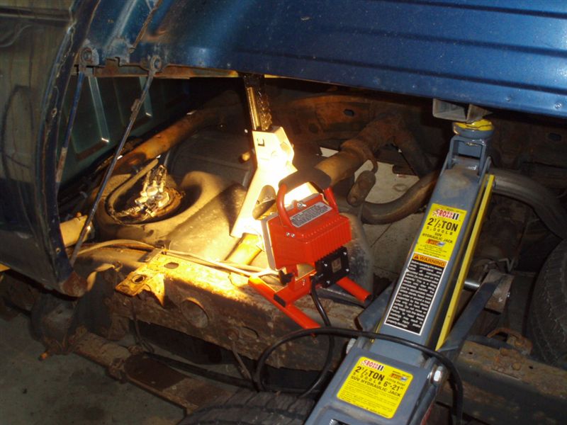

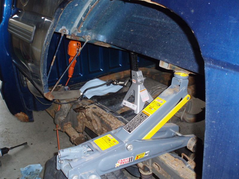

Here's how you do it by yourself. It helps if the paint is beat to hell on your 11 year old truck and you don't care about a few scratches. If yours is new use lots of towels between the bumper and bed.
First, give the tow truck driver a 10 spot to put it in the garage for you (expecially if you driveway it uphill like mine)
1) Remove Tailgate to reduce the weight of the bed. It takes 30 seconds so it's very worth it.
2) Spray lots of PB Blaster on bed bolts
3) Remove 8 bed bolts with Impact (you'll need a 6" extension for 6 of the 8).
4) lift bed (it's not heavy) and place something in the wheel well to hold it up some. Then slide in floor jack on tire. Jack SLOWLY. The bumper on the passenger side will keep the bed from falling off. Place towels or blankets in between to save paint.
5) place jack stands on tank and frame rail (see pics). Let bed down but keep jack in too foranother safety. Shake bed good to make sure its secure because it will ruin your day if it falls on you.
6) Remove rusted to hell ring from the pump by spraying the crap out of it with PB and beating with hammer and chisel/screwdriver. It will go eventually. Vacuum up all the dirt, salt and rust chips, then blow it off with high pressure air to make sure its very clean there. You don't want anything to fall it the tank.
7) Remove electrical and the fuel lines
8) Fuel pump pops right out after that
9) Reverse and you're done.
10) Replace fuel filter (unless you're like me and the filter is completely rusted to the fittings and won't come of. Then soak it with PB for about 4 days in a row and try again).
