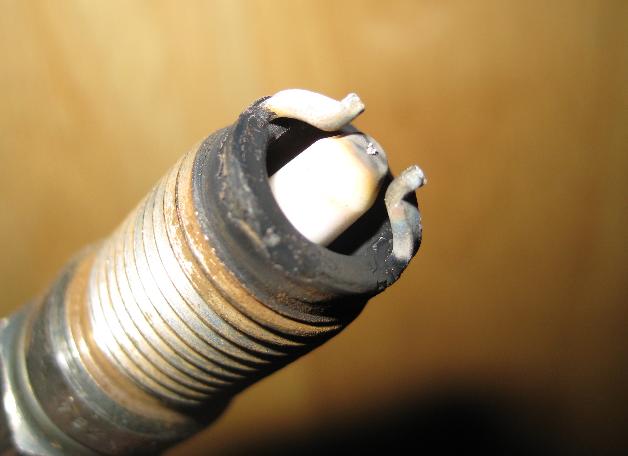

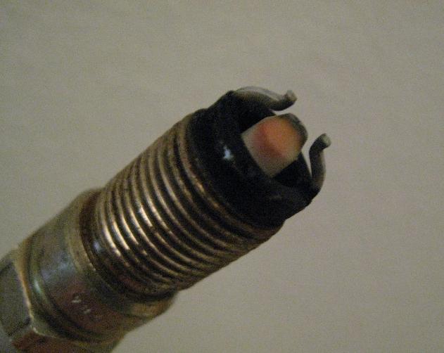

FYI, the bosch plugs looked pretty bad (running rich), but not terrible, and they all looked the same... cylinder 1 didn't look any better or worse than the rest of them...

Also, I'm uploading a couple pictures of one of the plugs... they all look the same....

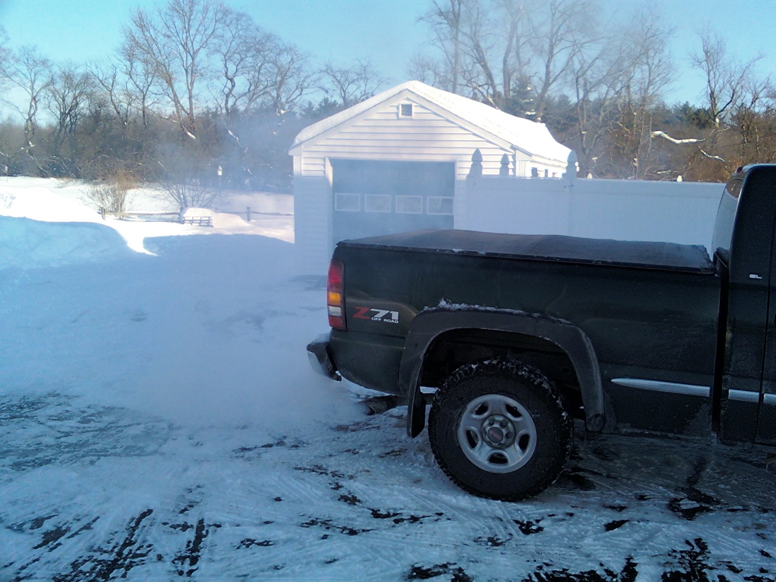

ohh, and just for kicks, here's a picture of the truck post-seafoam...
