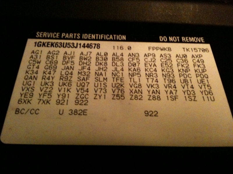

What model transfer case and what size rear axel does my truck have? I need to find out if it has any type of lockage in the transfer case and I need my axel size so I can go ahead and order my locker.
Thanks
Check the RPO list in your glove box.
GT5 is the 4.10 axle and GT4 is the 3.73.
Here are the transfer cases:
Automatic Transfer Case
New Venture 236 NP8, New Venture 246-NP8 - GM Auto Trak II Transfer Case Fluid
Borg Warner 4481-NR3, Borg Warner 4482-NR4,
New Venture 149-NP, New Venture 149-NP3,
New Venture 263-NP1, New Venture 261-NP2 - DEXRON III Automatic Transmission Fluid
Or check this site to decode any RPOs:
http://www.lonestarthunder.com/m_rpo.php
If your RPO list is missing, you will have to have a GM dealer run your VIN to find out which options your vehicle has. Good Luck!

I've got my RPO list, quick question.
What are the codes for the various cases listed above? Thanks!
