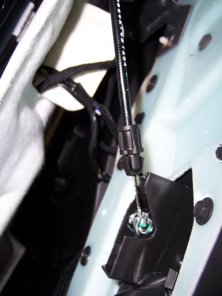

Here is a good picture of it. When I changed mine I looked around for instructions and found a place that sold mirrors and a post on another forum . They both talked about how you can end up bending the cable if it is left attached so I unhooked mine when I changed my door handles.I looked and could not find the post. In the picture you will see the tabs squeeze them both and pull back and it will release.post-55158-1233247139_thumb.jpg
Ditto what he said, getting the cable loose is easy, getting the cable sheath and sassociated clip holding the sheath in place is the hard part. Compress the tabs on the back side that you can't see from the top and push the sheath out. Then unhook the steel cable part.
