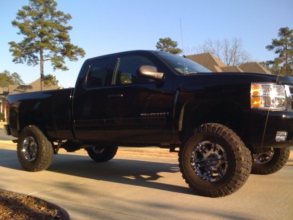

I had a body lift and leveling kit installed when I bought the truck in Sept. of 07, and then I had the BDS installed in Aug. of 08. Fabtech is a great lift for these trucks as well. Fabtech is one of the more prominent lifts in my area for sure.
I went with the Fabtech. I have beaten the truck up a little bit and I am happy with it. I actually hit a bump last weekend and the front of the truck was airbourne. I was fuggin scared but after looking at everything, it was all fine. All of my angles are nice and flat so shouldnt wear anything (ball joints, cv's, yada yada) down prematurely. I mean, maybe faster then stock but should be fine.
