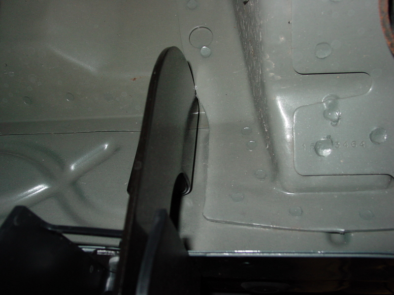

The mount points are the same as the GM 3" step bars, which I recently installed. There is definitely a slight interference with the 2nd bracket from the front, on the passenger side. There's a small bracket welded (on the Crew Cab at least), that looks like a reinforcement of some type. The interference isn't enough to stop the install, but I noticed it since that specific bolt was "tight" going in. It shouldn't be an issue, but the "fix" is to grind back the tip of the bracket and repaint, so that it clears that little reinforcing plate. I left mine as-is for now, and will only modify if I notice a noise. I'd bet a big wad of $$ that no GM shop does the grind/repaint/install procedure on these as SOP.

You wouldn't have a pic, would you Musicman?

That's correct. It's just to prevent corrosion of the bracket itself, and wouldn't hurt anything if it did rust. Any protectant (tar) would do the same thing. Here's a picture from the underside of the bracket touching the reinforcing brace. It's hard to see, since it just barely touches.
Thanks Musicman. There does appear to be a big difference in the rockers construction between the CC and Ext cab. At that same joint on mine, there is a big bolted on brace on top of what is shown in your pic, that is sure to be a problem as it stick out even beyond(forward of) the layers of spot welded steel. I'm thinking the dimensions are alot different as the strenghtening "X's" are wavy on yours, straight on mine.... I'll try and post pic tomowwow
