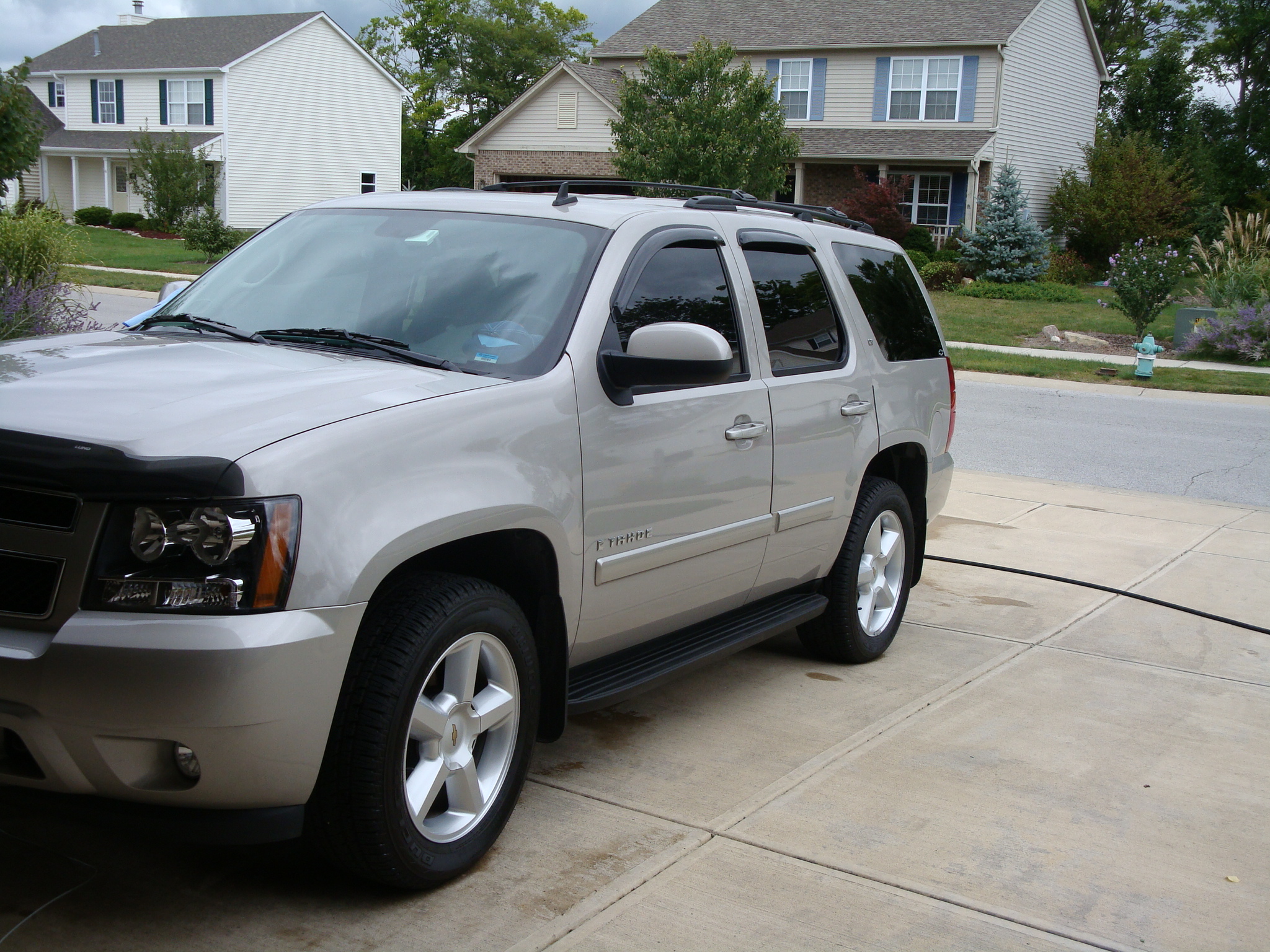

Look at my pics. You can see on the pic from back to front, the front is slightly lighter because the light allowed through the windshield. On the pic taken from front to back, the back window allows in a little light...when looking at it straight from the side (sorry, no pic) it is almost not noticeable.
