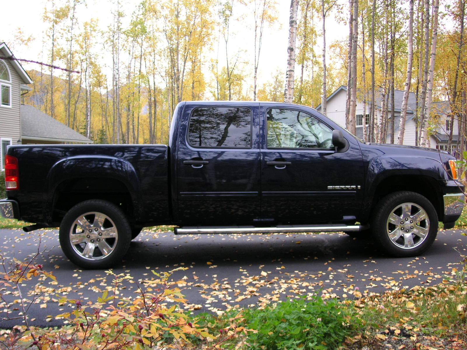

I put the Ready Lift kit on my 09 Sierra. I bought both the front level kit, and the rear 3" blocks to put some rake back into it for towing my offshore boat. The front leveling kit by Ready Lift leveled the truck perfectly. Pretty damn easy to install too! Should be able to run a 285/50 on those 20's, or a 33/12.5-20. Haven't put new rubber on mine yet ...still have the factory 275/50-20's. But planning on an aggressive 33" all-terrain/mud terrain tire. The rear block kit gives the truck just enough rake for hauling a load, or towing the toys ...yet not as much rake as stock.

No guarantee from me on the 33" tires, but thats what the web-site claims for this kit. I plan on running 33" BFTA's on mine. However, if you run those molded mud-flaps, you might get some rub on them at full lock. Thats been my experience in the past at pushing the limits of tire size.
Some before and after pics ...

I wouldn't do add a leafs, I would go to a junk yard and find the same year truck and get some 3/4 ton leafs and swap them for my half tons. I am going to look into that ready lift kit. My truck didn't come with mud flaps but I will have to put some on when I get all this work done. I appreciate the info, and your truck looks great!
