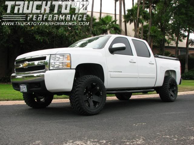

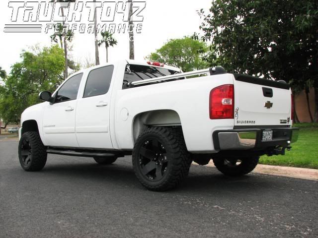

No rubbing here... (always some trimming is needed.)
thanks justin, I really like your tire/wheel combo too. really nice stance. Johnson too. What width are your wheels?
I definitely would like to avoid wheel spacers if at all possible. Ya'll might have convinced me not too go soo wide. would definitely save me from potential headaches in the future.
Any guess as to the width of these rockstars? I know the centercaps are off but they look pretty wide
