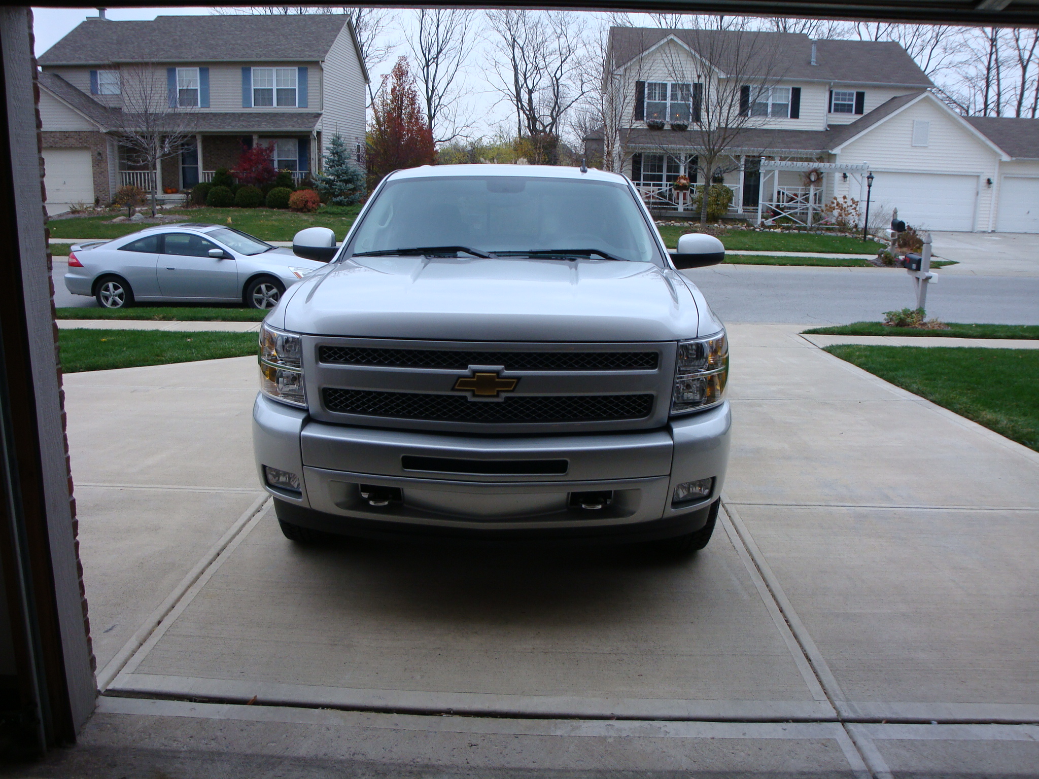

I went with the Z71 pkg because of the Z71 appearance pkg (rancho shocks, gage cluster and painted front end).

Great truck by the way!
