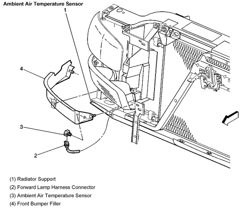

Where is the sensor located? I thought these derived the temp from the MAF sensor.
It's in the front of the truck in the grille area....not sure of the exact location but it's not getting it from the MAF...

Does the engine system rely on this sensor for any computations requiring accurate air temp, or is this sensor solely for the mirror thermometer? And does it have a proper name to help narrow down my search?
It's only for the mirror....check the radiator core support. I just went out and looked at mine. Facing the front of the truck it's on the right hand lower side sitting in front of the a/c condensor and next to the trans cooler.
Does the engine system rely on this sensor for any computations requiring accurate air temp, no
or is this sensor solely for the mirror thermometer?yes
And does it have a proper name to help narrow down my search? ambient air temperature sensor.
On my '04, it's located below the passenger side turn signal
