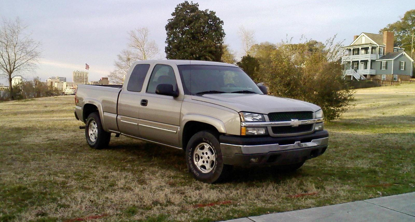

Evening Fellow Silverado owners,
i am a proud owner of a '03 Silverado 1500 Z71! Price was amazing just high milage of 150k miles, I love the truck and this forum has been a TON of help since getting it this past friday. The truck wont win a beautfy contest as i think it was a work truck but overal the driveline seems pretty strong. Thou i have some concerns.
