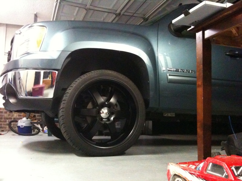

Thinking about removing my leveling kit and taking out the rear blocks to fill in the wheel wells a little better with these rims. I just need to know if its as simple as removing the ubolts and taking out the blocks and putting the u bolts back on or is it more in depth? I know that if you do drop shackles you have to loosen the truck bed. Do you still have to do that if you just take out the stock blocks?

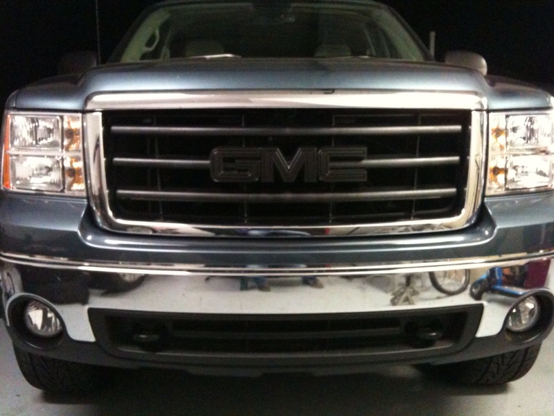

Also got a pic of the GMC logo I blacked out. no biggie just thought id throw it up incase somebody was thinkin bout doin it. Have a good weekend evrbody
