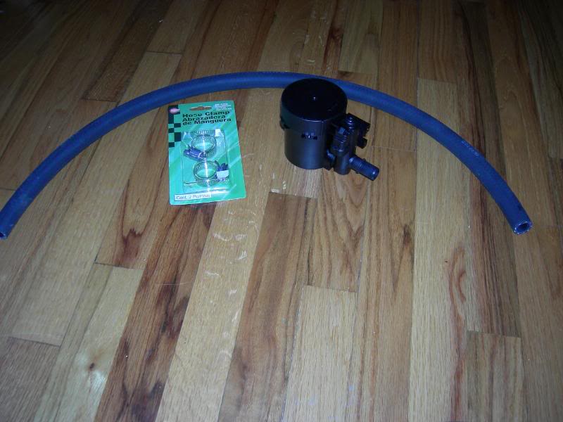

ok, so the vent valve is the black, cylindrical part that is about 3 inches tall, right? Has one electrical connector, and a tube running up to the charcoal canister, right? That's what is throwing the code?
This is what you're looking for...

UPDATE: ordered the part from RockAuto (214-2149), installed it, check engine light gone. 214-2149 works for the 4.3L V6. Thanks to all on this site...saved me mucho dinero. :jester:
