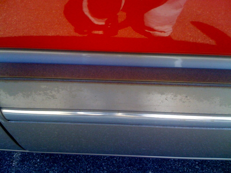

I have an '03 Silverado and the ding guard (if that's what you call it) has a rust color buildup on it. Anyone know what this is and how to take care of it??
The plastic is fading. You need to take and tape it off, sand, prime, and paint it really well. It's comon on the truck's that have the color-matched molding like yours. Mine(along with many others) have black molding, so we don't have to worry about that problem.
Thanks alot. Also just looked at it again and one piece has actually become unattached in a one spot. What adhesive should I use to reattach it?
3m automotive grade moulding tape. If your lucky, they have it at wal-mart, if not, a hardware store will have it.
