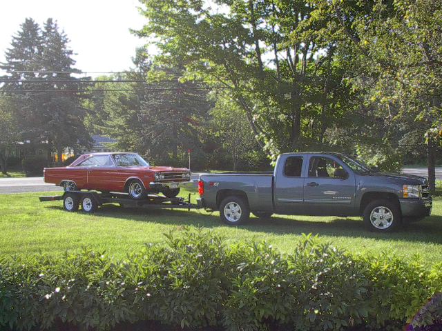

I went to Carlisle Pa a few weeks back and Towed a single car trailer(approx 1800 lbs wt) and a 67 GTX on it (approx 3600 lbs) from Buffalo NY. Used My new siverado...5.3...6 speed...308 gears. 4WD. I've been towing for decades and just got rid of a 97 ford diesel dually. The chevy will kick down on roads with slight inclines at low speeds(45) with no trailer. At speeds of 65 and up, it doesn't kick down as much. With the loaded trailer, I towed in "tow mode" and still was turning 2000 rpm at 70 MPH. (loaded trailer)
The truck did kick down on steep hills but not as often as I thought. I ran A/C over half the trip and got almost 13 MPG towing. It's not a diesel but I'm not all that disappointed in the capability. (the tow mode changes the shift points but still gets into 6th gear) I have been told on other topics that 342 gears and 4 speeds are getting anywheres from 8 to 11 mpg. I took the truck and empty trailer to Akron OH to bring back a 70 satellite. Empty one way...loaded the other and I got almost 15 average with the A/C running. I get over 18 local. I don't have a heavy foot for jack-rabbit starts but the truck has the capability to haul if needed.
In this case, I believe the best of both worlds are here. The 6 speed still gets the truck rolling quick and the 308's get better economy. It's not a "race truck" but still goes ok. I had a 97 silverado with a 350/5 speed stick and got better mileage and performance. That was a very nice combo.(don't recall gear ratio on that one)
Bottom line is,as I see it, a utility trailer with ATV's or whatever is nothing for this truck to haul.
