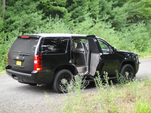

I had leather put in my 2010 PPV along with heated seats and now a few weeks later my seat wont move at all.Wont move forward back or tilt with any power functions. One very large problem is that I have a K9 insert mid kennel that takes up the area after the front seat :lol: Anyone have an idea how I can manually move the seat forward? I have the 40/20/40 front seats. thanks in advance!
