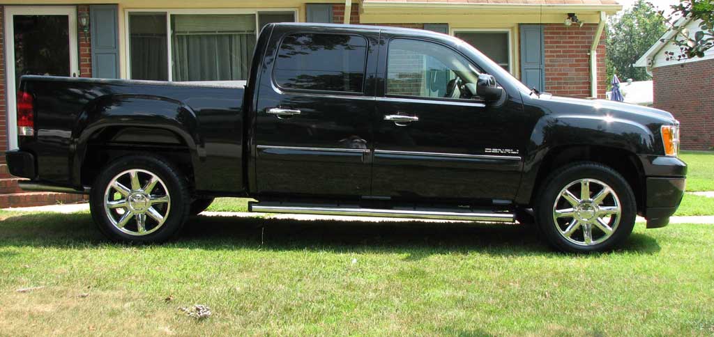

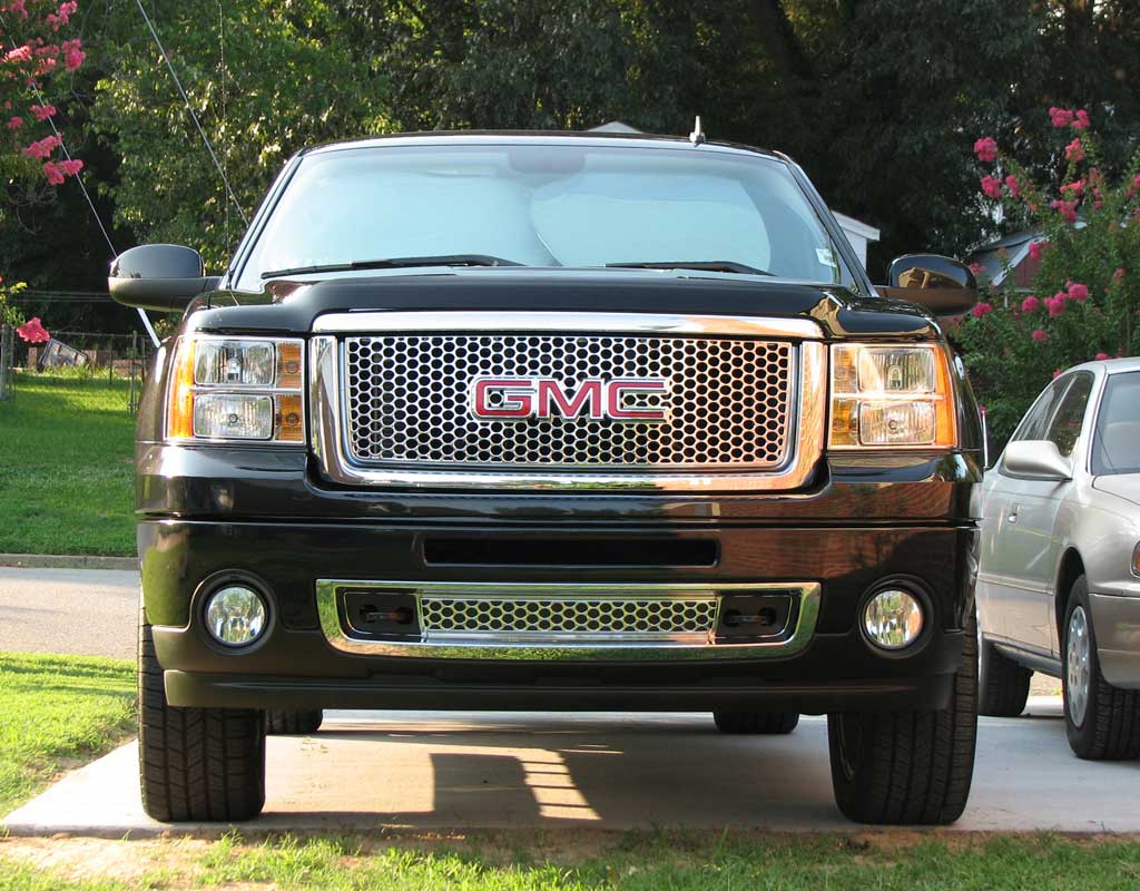

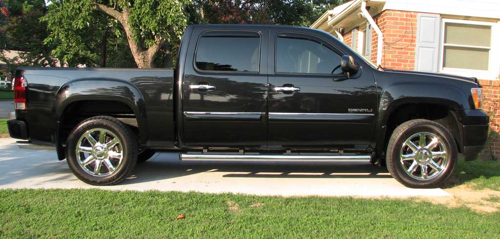

obxdiver Posted August 7, 2010 Posted August 7, 2010 This is the one I used on my 2010 Sierra Denali Rough Country Leveling Kit I gained about 1.75" in the front. The truck is perfectly level now. Much more stout looking, see below for Before and after pics. BEFORE AFTER the RC kit was installed.
